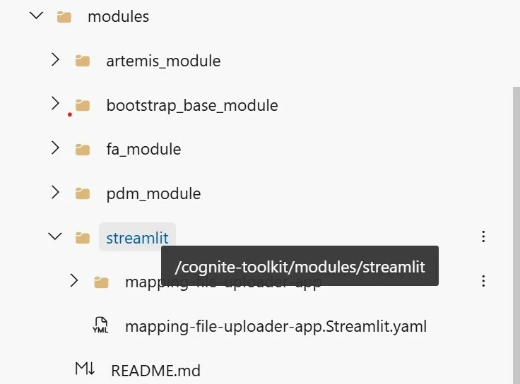

I have used stable version of toolkit and tried to deploy streamlit app. (Toolkit Version:  0.3.27  and Cognite SDK version:  7.72.2 ), following error is observed. Attached screenshot as well.
ERROR (ToolkitMissingModuleError): The following selected modules are missing,
please check path: {PosixPath('modules/streamlit')}.
HINT A module is a directory with one or more resource directories in it.
Available resource directories are ['3dmodels', 'auth', 'classic',
'data_models', 'data_sets', 'extraction_pipelines', 'files', 'functions',
'hosted_extractors', 'locations', 'raw', 'robotics', 'timeseries',
'transformations', 'workflows']

Hi ​@Basudeba Mandal , I wonder if the file structure is correct?
It should be something like
modules/<module name>/streamlit/<my_streamlit_app>
modules/<module name>/streamlit/my.streamlit.yaml
An example here:
Thank you ​@palronning . Its working now.
